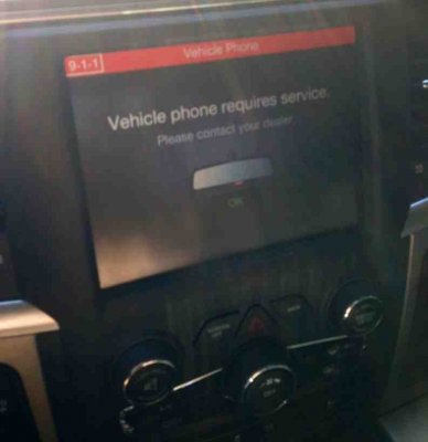

I have had my 2013 RAM 1500 for almost 3 weeks- absolutely love it... The only thing I can't figure out is uconnect.. I tried to register while in vehicle, but can't get a signal- it just searches... Bluetooth works great (phone and streaming), but messages aren't displayed in DIC...
Finally, i am also getting a "vehicle phone requires service" message every time I start truck.. Guess its no big deal as I don't need vehicle phone.. Any tips/comments welcome... Thanks!ImageUploadedByTapatalk1360867833.034639.jpg

I was getting the error vehicle phone was not working in my 2013 as well. Dealer had to replace the radio.
