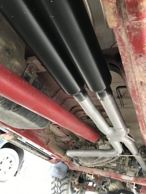

I have long tubes/CIA, true dual 2.5 and custom tune and my truck runs great!

Hi, following your exhaust post. My exhaust guy put a cross pipe in to eliminate the factory squashed merge pipe, 2-36" glass pack mufflers and left the rear pipes and resonators stock. My previous setup was true dual exhau with shorter mufflers like Corsa that left me with such a drone that I couldn't stand it. The glass packs had no drone but a nice deep rumble and sounded great under power. Either setup took a lot of the low end torque away. I did all this to help get a little more power towing our 5000lb 25' travel trailer. The pipes, either setup, did not add much power that I noticed but sure sounded great. What did help with power was the Vararam intake and BullyDog tuner. What they don't tell you, tuners or intake or exhaust, is that most power on a gas engine is at wide open throttle or at high rpms. Now that I'm 70 and have hearing aids, I went back to stock exhaust and keeping the crossover pipe. My health has left us not RVing anymore. But, the glass packs, even as nice as sounded, were too much for my hearing aids and hurt my ears. Sigh. Good luck with your journey, have fun with it!
