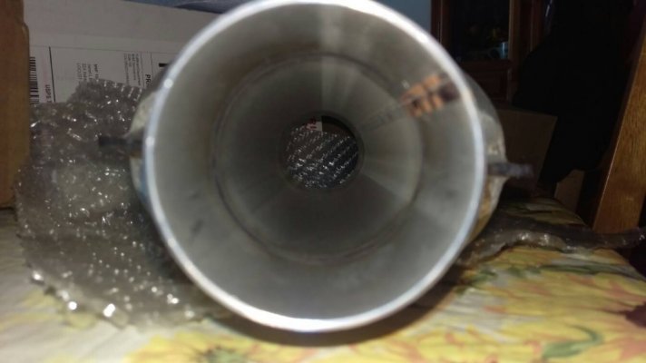

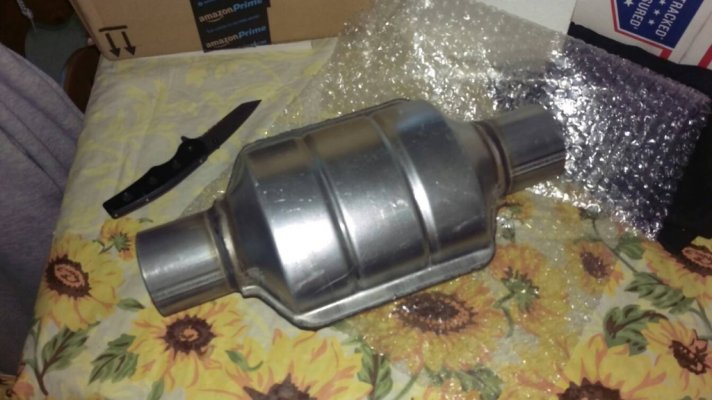

I have to pass visual, which I'll do with help from my fake cat. ae77830899cf482a74ec1ffc57574940.jpgea6888654493986c4b065c5390d7399f.jpg and I'll fool my check engine light with spark plug non foulers. Here in GA they don't test the actual emissions coming from the tail pipe unless you have an obd1 vehicle or older.

Ahhh living dangerously:devilfinger::devilfinger:hahaha. Well ill prolly just run a high flow cat and the spintech 9000. And call it a day.

Haha exactly. Yeah nowadays there's very little lose in performance or sound from using a high flow cat so you should be good. Glad I could help you out man. Make sure to get a video of the exhaust when you're done and post it up in the 2nd gen exhaust clip thread!
