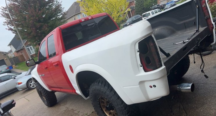

Or you can just find a used Ram Minotaur and drop in the drivetrain.

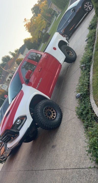

I have started turning my 2012 ram 1500 into a trx clone bedsides fenders dirt king suspension etc my next step will be to swap the dash wiring and dash with the trx parts I have already sourced all the parts and the whole driveline my question is has anyone done this sort of swap before?
@Boosted Motorsports has some youtube videos you might be interested in :)
Also, truck looks good so far. Who did the fiberglass fenders?

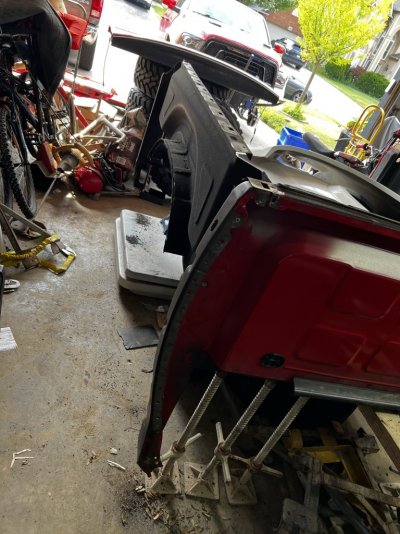

Thanks I did everything in my driveway
I think he meant who made the fenders (unless youre saying you bucked em in your driveway!?!?) either way Im interested in more details as well
