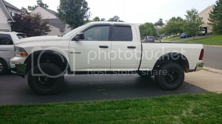

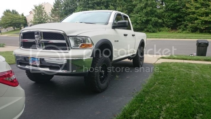

So after a few hiccups, I finally got our 09 QC lifted on the Tuff Country 4" with uniball upper control arms. Kit comes with front and rear lift spacers, lengthened upper control arms, new bump stops, and rear shocks. I went ahead and put on new front struts as well since we were going to have it torn all the way down anyway. Ended up having to get new front lower control arms as well, but that's a whole nother story.
It rides very good and handles mild offroading well. Truck os completely level. Put on DX4 7S wheels with -6 offset and Fierce Attitude tires. Time will tell if this sub-$1000 lift lives up to what we expect, but for now, we are very happy.
Before....
After...(parked on a sloped driveway so front looks high)

don't forget to adjust those head lights

You sure that's level? Looks nose high. Regardless, nice work! Always good to hear reviews on new products.

Yeah...it's level when sitting on level ground. I need to get a better pic.
No wobble in 4x4 as of yet, but I haven't been above 40 mph in 4x4.
