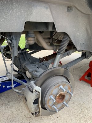

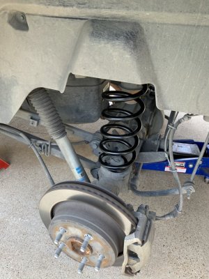

Once I got them in and set aside some time for the install it took in total about 45 minutes from tools out to tools back up. The first thing that you'll need to do is jack the truck up and place jack stands underneath the frame in front of the rear trailing arms. I elected to take the rear wheels off for access but I'm sure you can leave them on if you'd like, however, it did make this extremely easy. Next, I removed the lower shock bolt and lowered the rear axle all the way down on my jack, make sure you watch your brake lines if you have your truck jacked very high up. Once the axle was lowered you simply remove the old coils and swap over the top plate and put it back together, it really is that simple!
My first impression of the springs was that my truck no longer has the "Cali-Lean" and the ride is just as plush as it was before. I can notice less body roll in the corners but again, they did not compromise the ride quality.
