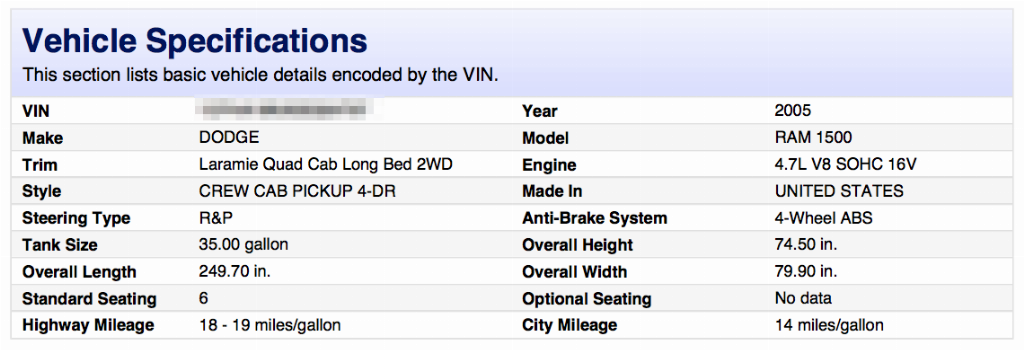

Six months ago, I bought a 2005 SLT 1500 quad cab 4x2 with a long bed. She's got 190k miles. The seller kindly provided all service records.
I've performed the following maintenance and looking for feedback re: am I missing anything?
