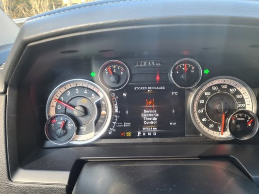

After driving 5 minutes, i got another error in my display: service electronic throttle control. Is this associated with my EGR?

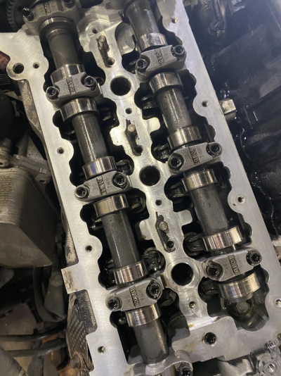

This has been discussed over at ram1500diesel forum at length.
Here was my intake after 423,000 miles. I ran an older GDE tune that had the soot recirculator turned off. If only the EPA could be held responsible for their requirement / the intake fires. The tune also turned off pre and post injections to save fuel and keep unburnt diesel out of the oil hence oil stays relative clean for the whole 10k change interval. Eliminated the foolish trivial check engine lights as well. Better mileage or power can add turbo brake. I read good things about MRTunings from EOC Ecodiesels of Canada as well. Below shows how clean IMO due to the tune and T6 oil with quality filter every 10k.
