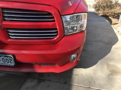

First...what type of headlights do you have?
Quads or projectors?
R
Redram15
Dec 19, 2016
24
Co
Not sure
R
Redram15
Dec 19, 2016
24
Co
Quads or whatever these are
Rzrman328
Aug 25, 2014
5,808
3,153
The treeline
K, pull your headlight out, pull the turn bulb out and test which circuit is for the turn signals.

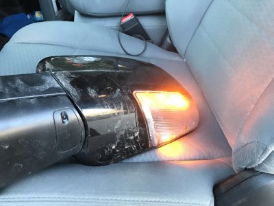

I got them to turn on but there really dim
R
Redram15
Dec 19, 2016
24
Co
I took it in and they said they flashed the codes but idk they didn't work

Is this bright enough?
Ricks Ram
May 1, 2015
4,411
3,415
There is no reason the codes should not work if your dealer added them to your truck. To try to hardwire them in is fine but I would at least check with another dealer to make sure they were added correctly. I have not heard of anyone having this issue.
