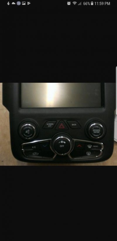

Am new to this site so please bear with me I have a 2014 ram and am trying to upgrade to the ra4 nav. #68224525AG after installing every thing I have No volume when using the dial on my bezel it is a single zone upgrade. The nav works and buttons work also I don't have steering wheel controls if I add them will this solve my problems? 67ac4c6bc4a2f20945406b108ca401a3.jpgff6105ae95aa8b530f9e8d0c494a8e9a.jpg
