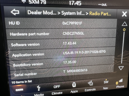

hud id 0xc79f901f
software version 17.43.44
application version USA-IR-19.9.0-20171026-I07G
BOOTMICRO VERSION 17.35.00
when I try to upgrade it goes in a update error loop for 2-3 days then comes back. this last time it said update not compatible for this system. it came with my 2018 2500 longhorn.

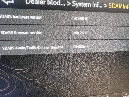

It looks like you may have a UAQ radio. What is the filename of the update you are trying to flash?

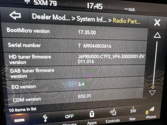

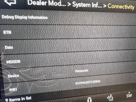

Not sure where I would find the VIN cant connect to the radio with AlfaOBD. I have an ezlynk connected and an obd reader that works with the body computer but cannot connect to the radio. The pictures are of all of the screens in dealer mode. Open to suggestions.

I recommendation not trying to flash it. Every radio I've seen with Error 20 has never recovered. It great yours has recovered to usable.
Its possible your issue could be hardware related to the GPS antenna itself. You can test with a cheap antenna from Amazon in about 15 minutes.
