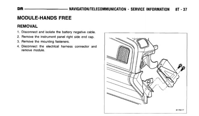

Pretty sure the 3rd gens have a separate module for uconnect. It should be under the glove box on the passenger side. If you take a flashlight and look around under there, you might see it. It should have a bluetooth symbol on it.
