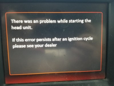

First I get
Than switches over to
Dealer wants $1k to put in new head unit. Is there any workaround? Will updating help like first screen suggests? This is a 2014 with 100k miles.

First I get
You can purchase an RA3 VP3 NA non nav radio on eBay for $300 to $350 pretty easily or the RA4 VP4 NA factory Nav radio for around $350 to $400. It's extremely simple to replace and there is NO special programming required. The radio the dealer installs is almost guaranteed to be refurbished so really not much difference. Any one will work from a 13 to 17 Jeep Grand Cherokee or Ram Pickup. Make sure it's either a VP3 NA or 4P4 NA depending on whether or not you want Nav. NA stands for North America. If the radio has CA for the last two letters it's a Canadian radio and will not have some of the features you currently have. You will need the 4 digit radio unlock code which you can easily get on line for $10 to $15 and that's it.

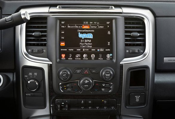

What is your current radio
RA 1 basic radio receiver, w/o navigation; AM-FM-Uconnect-3.0" screen
RA 2 display 5"
RA 3 display 8.4" non nav from factory
RA 4 display 8.4" with factory Navigation

The bottom pic looks like mine 8.4 with factory navigation.

What is it that you are trying to update
Is it a radio software update or a Navigation item
radio software update :
https://www.driveuconnect.com/support/software-update.html
I have no idea it is just a message that pops up on start up before changing to 2nd message saying there's a problem with head unit. Dealer was no help just wanted to change out unit for $1k which is a little pricey for me right now but he neversaw 1st message it doesn't stay up long.
The dealer wasn’t “no help” they just told you what you didn’t want to hear. You can’t repair your current radio, it’s bricked and needs to be replaced. They don’t install units off eBay so they gave you market price on installing a new radio and you didn’t like it. But that’s not “no help”.

Did you try pulling the battery cables? I had an issue with my head unit where an update bricked it. pulled the batteries and it reset itself after a bit of time.
couldn't hurt to try.

I have not pulled battery cable but did do the reset on here about pushing volume button and chanell buttons at same time shutting down head unit. Will check for updates

Guess we kicked the can down the road as today everything worked.
That's great. A word of caution, since it is working again I would caution against any firmware updates. As @IRSmart mentioned, often times these radios can become bricked. Applying a firmware update to a failing radio can sometimes accelerate this process...

I got that error probably the 2nd week after I got my truck brand new .... they said they needed to replace the unit and it would cost me $1800 and change .... I was like "are you kidding me, it's a brand new truck" they tried to say I caused it by trying to unlock it .... bunch of thiefs ! lol !!
I disconnected the battery like one of the techs at the dealer said to do and it fixed it lol ...

If the radio is not on the latest firmware you should try to update it to the latest firmware version. These radios keep an image of the previous firmware and have a hardware watchdog that will boot to the previous firmware image if the current firmware image is corrupt. Basically the radio is running off the backup copy of the previous firmware. If something happens to that backup copy, the radio will be toast. By applying the latest firmware, the radio will then have two good copies of the firmware.
