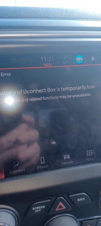

Hi everyone , I have a 2022 1500 Warlock classic with the Uconnect 8 no nav . I have had nothing but trouble with it . Started with the usual dumping presets ,so it was updated by dealer . Kinda helped that .
Other issues that have popped up are , data loading 45 minutes plus and multiple restarts before screen comes on . Steering wheel phone controls don't work , if android auto is not on you get see device manager or can't be used while vehicle is in motion .
The vr button works with android auto for directions but that's it . Tried to make a call and it called overseas so can't trust that . To make a call you have to say the number then it says calling whoever you are calling from your phone book .
Also getting low battery message on occasion.
Do the steering wheel controls work without Andriod auto , supposed to be able to do many functions such as change station , source look for song on usb , no beeps no nothing .
Has anyone else have these issues or do I simply not know what the heck I'm doing . Looking forward to your replies.

Sorry should have been more specific, tthelow battery is for the uconnect system not the truck battery

Well, I did a factory reset on my Uconnect system and another 30 minutes to tweak all settings and other stuff . It actually is working ,maybe not 100 %, but better than it ever has .
