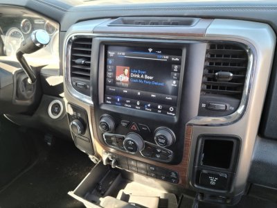

I just gambled on a 4c from a wrecked 2018 Chrysler 200. These seem to be a little cheaper because of the non-interchangeable aluminum bezel and car they come from. After cutting off all of the tabs and hitting it with a flap-disk to smooth out the edges, I was able to fit my existing bezel from my 2013 Laramie around it. I DID have to make my bezel a two piece design (lol) but it seems to be in there nice and snug. I'm totally happy with it.
Radio is P# 68332807A for those that would like to give it a shot. Confirmed working as of today.

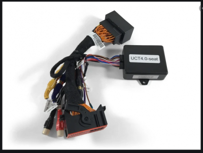

4. Like many, I've lost my steering wheel heater and also the seat heaters/AC. Again, seems like an expensive harness that I can just re-wire myself. Although, I came across this pic of a box UCT4.0?? harness.png
