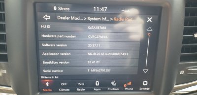

Can anyone confirm what you get for a notification? In my case I get the message (see image) and my radio controls are frozen. Can't change sources, can't change FM stations, can't change volume, Android Auto will not connect, etc. etc.
Basically, my stereo system is neutered.
(BTW, 2018 Big Horn, UConnect 8.4, stock 6 speaker, non-navigation system. I believe I am currently running software version 22.6.)
Is this what others are seeing?

Yes, couldn’t do anything until I chose a time. When I went to the truck this am, it just said it was updated click here for more info, I clicked that to see what was in the update....it then said an update to uconnect was the details of the update... ya thanks fca.
Well I didn’t notice anything different but I didn’t turn the radio up either to see if the audio still sucked
