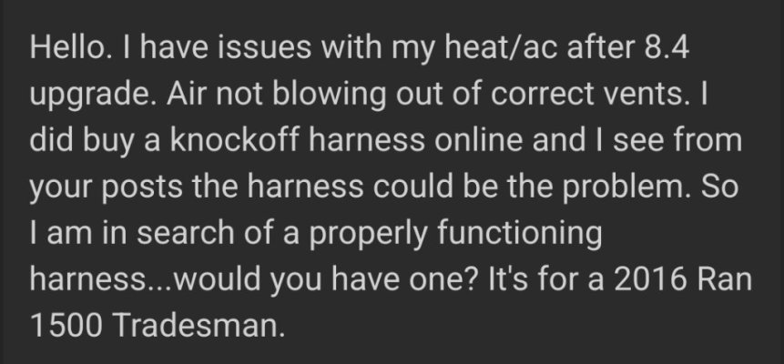

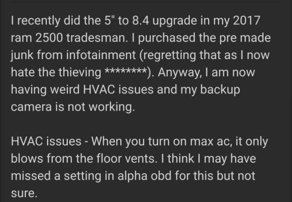

Here's just a few examples from the last week ...
(& A similar thread here)
