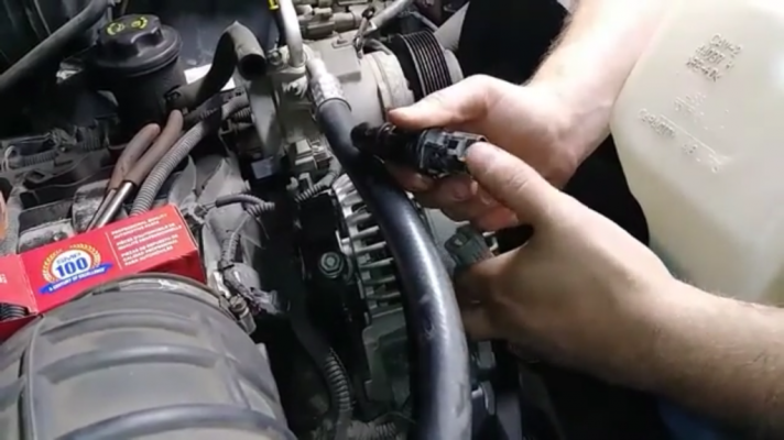

Can ANYONE find me an image of the wire connector to the Cam Position Sensor ????
I cannot understand how to disconnect it in place in order that I can get a real grip on the composition sensor in order to extract that ........
I have studied all the other connectors under hood....none are just the same.......
Two Beers to the first person who can post a picture of the sensors and the connector showing the disconnect tab....
I don't dare tug on the connector or I will break it and then not be able to plug into the new sensor .....if I ever get it installed.

this is a 2007 1500 but a 5.7 hemi
At about 17:00 minutes in it shows the connector.
Don’t use a knife use a small flat head screw driver

Thanks finally got it off with your help.
