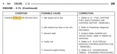

I have a 2004 Dodge Ram 1500 5.7 Hemi engine I replaced fuel tank fuel pump cam sensor crank sensor hard reset the tipm and I'm still having random stalling problems my stepfather said it could be fuel pressure or fuel filter but nothing seems to be the case it just unexplainably stalls does anybody have anything to suggest
