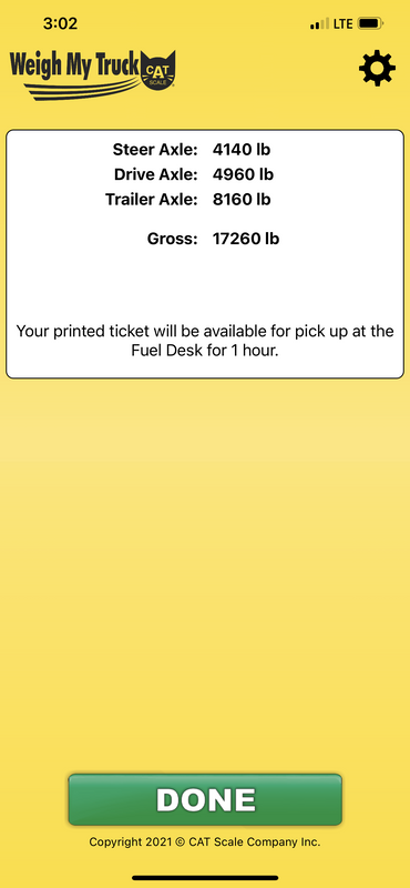

your trailer wt. numbers are very similar to mine and my 1500 laramie pulls it fine..looking at the wt. on the rear axle..looks to me to be too heavy tongue wt. too light on the front axle. wdh could be improperly adjusted or you have loaded too much gear in the truck bed and front storage area of the trailer. when I tow my 28' 6000# trailer the wt. on front and rear truck axles is nearly equal, with the front being a little more. I get no tail wagging and if the terrain not too hilly, can set cruise for 68-69 and it holds fine just under 2000 rpms. go to an rv dealer and get your wdh readjusted..add airbags..be careful how you are loaded..

It looks like your Weight Distribution Hitch is not cutting it for your trailer. The specs for your trailer say it is a 640lbs hitch weight, which is probably going to be closer to 700 + pounds in reality. Your GVWR for you trailer is 7680lbs. 4815lbs dry weight and 2865lbs cargo carrying capability. Even though you probably do not tow with over a ton of cargo in your trailer, you are going to be over the advertised dry weight when loaded up as you know.
My 2018 Ram 1500 I was pulling a Keystone Hideout 260LHS (29'11" feet overall, 5182lbs dry weight, 645lbs hitch weight) My actual hitch weight is 710lbs., and was about 5600-5800lbs loaded out to go(empty tanks). I pulled it fine with my 1500, almost maxed on my axle weight for the truck. Over payload on the truck, but still under gross combined weight rating (truck & trailer together). Kids got older & bigger/heavier....
I would go back to the dealer you got the hitch from and get another one rated for 800-1000lbs instead of the 600lbs./6000 rating. RV dealers usually do enough to get you down the road to make the sale.
If you want something that is easy to setup, look up Weigh Safe TruTow WDH. I want one of them for my setup.
As for what others have said, numbers don't lie and you need to make the best decision for what to do.

I agree what others have said your WDH is too small! I weighed my 30 foot travel trailer on a CAT scale when they weren't busy then unhooked the camper and got a total loaded weight 8400# I bought a Sherline 2000# trailer tongue scale from Amazon. My current tongue weight was about a 1000#s on the hitch, but still had some sway. I had an equalizer 1400# WDH. I checked the attitude of the trailer and had the nose slightly lower than the rear.
I put my hand on the back of my truck box one day (without the camper) and gave it a few jerks side to side. I could see some sway there. I pumped the tires to full sidewall pressure and it helped, but still the sidewalls had some sway. Rather than go with the hard riding E rated tires I bought some D rated KO2s. I tried the same side to side jerking and saw virtually no sway in the sidewalls.
I towed my TT with empty tanks, tried adjusting the WDH weight shift multiple times ,but found out by loading more weight to the front of the travel trailer to about 15% I had eliminated sway even when going down steep hills (7%) with semi trucks passing me. Now at 8400 and 1200#s on the hitch I had very little payload left considering the RAM towing chart said 1480#s. I moved up to a 2500 and eventually a 5th wheel camper. Good luck getting it sorted, I know the uneasy feeling of having the camper swaying around.

Yep. Not sure if I posted this in here already but my son has a 2018 Grand Design Imagine 2670MK. Dry weight advertised was about 6600lbs with 690lbs advertised tongue weight. He was actually at 1100lbs tongue weight but he was loaded heavy. The TT weighed in at 8100lbs. He has a Husky Centerline TS WDH with the 800/8000 bars I believe. I towed it with my 2013 1500 about 150 miles but it was new off the lot and completely empty so didn't weigh that much. He now tows it all over the country with his 2018 2500 6.4 with no issues at all.
My step-son just bought a 2021 Imagine 3250BH. We weighed it at 9300lbs. He has an Equalizer 1200/12,000lb WDH.
Here are weigh lips from both:
