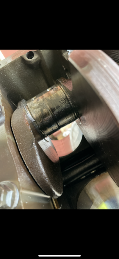

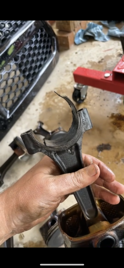

I just got off the phone with Arizona Engine Rebuilding 8/16/22 and basically the hole bottom end of that motor is (F) Ducked. The crank shaft is toast along with 4 connecting rods and vvt solenoid and slew of other parts. There was so much metal in the motor the oil pickup was clogged. Dave said he has no idea how that happen he started to try and blame the aftermarket cam I brought from green racing saying how the high spring tension on the lifters can cause excessive heat... I then asked him how that would affect the crankshaft and connecting rods. he had no answer then moved the conversation to another topic. So basically from what i gather he need to talk John who i think is the owner for they want to handle this. I have a feeling they are going to try to get me to pay for this at least a portion.
I am sure it goes without saying but I do not want to deal with there BS, If they didnt feel comfortable installing an aftermarket cam, lifters, and springs. they should of told me when I told them about it. They follow the instruction on how to setup the spring tension. But didn't follow the instruction for first start up. The instruction the cam came with said Run for 30 min at 2k to 2.5k rpms then dump oil. They ran it for an hour at idle and I don't remember if they said they dumped the oil. I just want my truck done and done right. Granted i don't know much about building motors, but I am not doing anything exotic or out of the box. Its a HL cam, its not like I asking them to put a turbo with a nitrous system.
Thanks for letting me vent I am so pissed off and frustrated and I have this gut feeling that it's going to get worse before its gets better.
Do you have a list of what parts they installed? I'd like to see a whole break down and see if anything sticks out to anyone here.
Did you just do an MDS delete and cam/lifter swap? VVT Phase limiter? I don't know a ton about the internals of these engines but a few guys here are very knowledgeable. If you get us a list maybe one of them will chime in.
I also don't see why that would have anything to do with the bottom end but maybe someone else can see an issue from a parts list.

Ok you said they did a full rebuild from top to bottom, so new rings, main bearings, rod bearings, honed the piston bores, and then everything involved in the cam swap?
Reason I’m curious here is because nothing involved in a cam swap would cause multiple rod bearings to be destroyed. 98% of the metal you are seeing in the engine is bearing material and a little metal from the rod journal and crank.
If they rebuilt the bottom end, my guess would be they either installed the wrong sized rod bearings or didn’t torque the rods down correctly. Any extra slack around the bearings and it would idle all day long but when you start putting a load and turning some RPMs it lets the crank journals “wiggle” in between the rod bearing and makes contact with it (should never touch metal to metal because there is an oil barrier provided by the oil pump) Once that bearing gets eaten up, the clearance where that oil barrier was around the crank journal is roughly 5x larger which causes the oil pressure to drop. Oil temp rises almost immediately because of the friction from metal to metal contact.

Now I will say it is possible for something I’m the top end to fail and send metal particles down into the oil then pumped back into the crank, eventually getting in between the journal and rod bearing, but you would very easily see the broken part to cause that in the top end.
When I destroyed mine I had an oil issue where it had set for 3 months but only had a few miles on it (torque converter issue and back ordered parts) apparently sitting over the summer in Louisiana can get condensation in the oil pan. About 2000 miles into the cam swap and a good 25-30 passes at the track, and it completely seized the engine at 6800rpms. No warnings or anything, just lost that oil barrier from having loss of viscosity and and within 3 seconds, it was finished. If I can figure out how to post a picture I’ll show you what it looked like.

I’m not sure if you could call oil pump being the issue because the sump tube was full of debris and the debris made it to the top of the engine and into the vvt solenoid.
Another thing that baffles me is the fact they rebuilt the engine and just let it idle. That’s a red flag because a fresh engine build is supposed to idle for a very short time to make sure everything is functioning correctly, then cycled between 2000-2500rpm to seat the rings. All of the research I did when doing my rebuilds says that even during the 500mike break in, avoid excessive idling.

Is it possible the cam bearing tolerance was too tight with that aftermarket cam, causing the bearing Depree to get spread throughout the engine.
CrasherAsher
CrasherAsher
Mar 21, 2021
117
104
Mesa
2009
I dont see how the Cam bearing can affect the connecting rods bearing and crankshaft journals?
