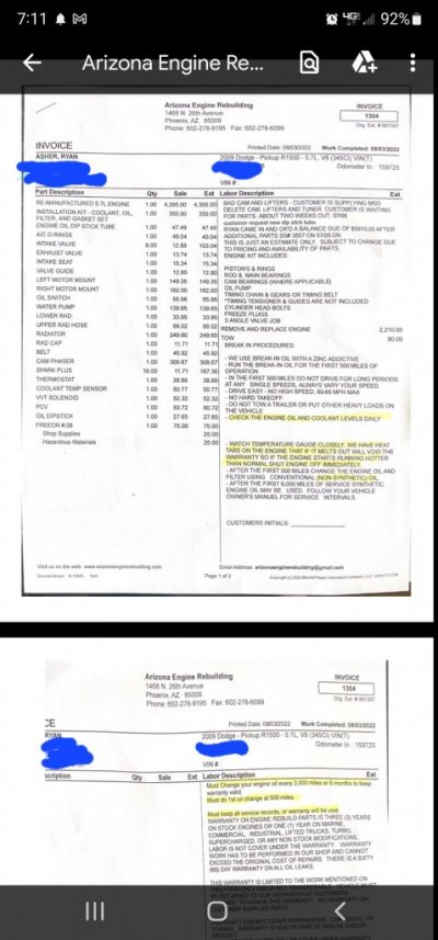

I know it took me awhile but here is the invoice for my trucks rebuild.
@Wild one Can you help my buddy out here? I don't know enough to really have a solid opinion on these parts. Yes please laugh at me if you want, but I know you know what you are looking at. I have only messed with bolt on stuff so I admit I don't know what I am looking at here.
@DILLIGAF same to you too, you guys have dove into the insides of these engines before, I have not.
Thanks gents!
@CrasherAsher Where are you at right now with these guys?
ColesRAM
Jul 1, 2022
247
288
NE FL
5.7 V8
I know this comment is irrelevant, but why the hell are they charging you $4300 for a reman'd engine and then go on to itemize a ton of parts of the engine as well?
WTH was the $4300 for?
Thanks gents!
He's going to have to do a better job of posting his invoice,as i can't read it.

Plus you got an engine kit, and timing chain guides and tensioners were not included? Really? Everything else was new except that?
Plus, no mention of prep work either. Hot tank, teardown, etc. If it were my shop, there would be detailed listings of stuff done, in order of progress.
