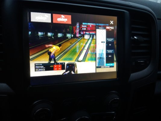

Lol i push it all the way to the lefthand side of the cluster, cant see my rpms but everything else is just right. its a good way to watch a football game if you happen to be on the road
