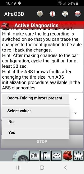

What are the setting that need to be changed with the alpha obd when adding the power fold mirrors?
Ricks Ram
May 1, 2015
4,411
3,415
Only one code is needed. Doors section. Doors folding mirrors present......select yes. 7ab15be9bbb3d4ec81187fdec32d17d9.jpg
Deepjeep85
Mar 9, 2020
13
42445
5.7L
Thanks I was kind of confused because my door modules have the extra port for the power fold mirrors, but they still don't work by changing this setting. Mine is an express and I didn't even look at the module pn when I had the doors off. I just assumed that the original mirrors only had one plug where the power folding have two, but it did have the extra port on my stock door modules so they would work. I guess I will need the 68225102AC/103AC modules
