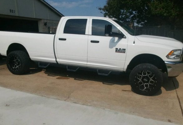

2.5" Level on 20x12s wrapped in 305/55r20 ridge graps minor plastic trimming required. Lost about 1mpg4053bfb01ed25129ea936f1fa3e262d9.jpgf6cf72c7c6df0b4fcdf66b597a555b2b.jpg

Looks great! Little wider than I am going with the 20x12. Gonna stay with a 20x10 Fuel Diesel and the Ridge Grapplers. Have the fender flares and the running boards on mine as well. Thinking it will have a great stance once complete.

20x10s still look good. I like the wider stance to each their own. As long as they aren't tucked or dead even with your fenders it'll look good. I guess I'm just too "gangster"
