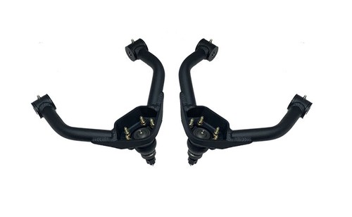

So iv been searching online and have had no luck. To start it off I'm restoring a 2003 1500 ram 5.7 4x4. Currently running 3 in body and about 2 1/2 inch suspension lift. I'm going thru upper control arms about once a month. Now for the question what difference is there in the upper control arm between the first 3rd gen and the later.(2002-2005)(2006-2009)? Iv found plenty a arms for lifted truck 2006 up.would a 2006 fit a 2003? Oh and while I'm at it can lifted 2wd spindles work on a 4x4? Any info would be greatly appreciated.

2 and 4 wheel drive share the same part number. I just found these. I believe that I am going to take a swing at them. I am eating upper ball joints myself

It is. Iv had a lot of issues with my 03. But at the end of the day . She's my baby. Any luck on the upper control arms? I have a question. Does anyone know what the difference is between the 03 and 06 front suspension

From a quick glance at rockauto.
2006 uses coils springs on 4wd, while 2003 uses torsion bars - arms are shaped differently, would they fit? I have no clue
The knuckles are the same between the 2 years on Rockauto, however the parts numbers between 2wd and 4wd are different.
Might be worth taking a drive to a pic-a-part and compare in person.

Thank you. It's insane the difference in prices between the 2 style 3rd gen. 06 uppers are around 150.00 for lifted while 03 are about 500.00. iv also been searching for a lifted knuckles.
