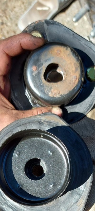

Adding to this old thread. I had the same issue and blew through 6 mounts (3 pairs). First were the KYBs, second 2 pairs were Monroe. Every time the washer was installed in the correct order, torque to spec, and 4-8 months later the squeak is back. It's like the Bilstein threads are chewing through the mount. Now both Bilstein threads are completely worn off on one side and now I have to trash them.

Bilsteins have got to be the most popular aftermarket shock in existence for these trucks and nobody else is having this problem.. they were the OEM lift option in Mopar lifts too.
Nobody likes to admit they were doing something incorrectly but what other possibility exists here?
