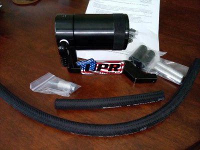

Never heard of catch cans before! Until we bought our 2019 Ram Hemi. Funny because I am not a automotive newbie.
Any way, after some R&D. Decided, yep I need one. But $300 ?????? And of course the $30 EBAY specials were not very encouraging.
I finally decided on the UPR Model For Ram 1500 5.7. It appears to have most of the requirements for a good catch can and not wildly expensive. On order.
09-20 Dodge Ram 5.7L Billet Oil Catch Can Z Mount $139.98
After install I will check and see how much crud I catch and how much oil is getting past it by checking hoses and connections after the can. I think this may be a valid indicator of performance.
Any thoughts? Or has this horse been beaten to death already LOL

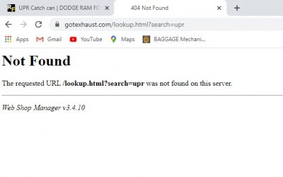

I tried the gotoexhaust website. And got frustrated with it acting up. At least for me. So I ordered it directly from UPR.

Received from UPR today. Well made Good hoses rated at 300 PSI.
Will install in a couple of days.

Too bad, I would have been happy to use a site sponsor. I kept getting a web site errorerror.jpg .

Too bad, I would have been happy to use a site sponsor. I kept getting a web site errorView attachment 213673 .
Next time!
yeah I know its not working. Major changes have been made to the site and lots of products have not been added. Just message me with ANYTHING you may need. We offer most products for the RAM!

I like my UPR catch can but not their hoses and their installation instructions are not very good. My can is not labeled for in and out but I looked up the design of the UPR catch can and figured it out. Proper installation shows the inlet and outlet hoses cross each other. The inlet is the open side and the outlet is the side with the filter.
Nov 20, 2018
74
Riverside California
2018 2wd
HEMI 5.7 Revolution 4.88s
Does anyone know the size of the 90° elbow fittings and where I can get them in black ? I know the hose is 1/2" but what about the threaded side, is that 3/8 ?
whetrick1
May 21, 2016
1,311
301
Get a 1/2 and a3/8 and take back the one you don't need. Or take one of the fittings in and match it up. Probably will have to get a brass one and paint it black.
Nov 20, 2018
74
2018 2wd
That is what I ended up doing, painting the ones it came with black ...
