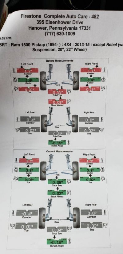

I got the report back from the alignment and I'm confused. They didn't touch the camber. Am I wrong to have expected them to fix that? 560c56130565e8d51768e61b9c912f80.jpg

Alls they did was set the toe I bet . The slight camber change is probably just a by product of the change in the toe setting on the right side. Should still be a larger difference in the caster setting side to side. Passenger side should be higher than the drivers side by more than the .1 degree that you have now. 3.9 is OK for passenger side but dr side could be lower to establish the better setting. No reason for anything to be in the red with any Bilstein setting
