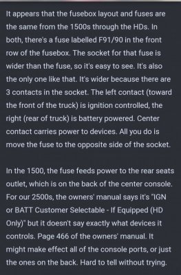

Are the 2 USB ports inside center console always hot?
I have something plugged in and even with truck off and locked and waiting 5-10 minutes the device is still on and working as I can see it broadcasting SSID.
Wondering if there’s a way to move or adjust a fuse so that the port turns off when the truck is off? Or is there no way to make it cut power to the ports when vehicle is off?

I checked the fuse. I had it on acc. Switched it to battery to see if it made a difference and it didn’t.
After 1 hour I checked and device was still powered and on.
At about 1 hour and 50 minutes the device was OFF. I was able to verify two different ways and it was totally off.
SO, either the truck DOES kill power between 1.5-2hrs to the USB ports OR the device itself times out. Either way, I guess it works out for me. I’ll keep an eye on it, but so far so good, thanks everyone!!
