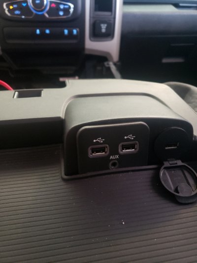

Confirmed Ram Radios:
2018/19 classic 4th Gen Ram Radio: (USA)
68331631Ax (UAQ 4c Nav)
or 68331635Ax (UAS 4c non-nav)
2020 classic 4th Gen Ram Radio: (USA)
68461703AB (UAS 4c non-nav)
and here's a picture of the Chrysler 200 hub installed in my parents 14 ram bighorn with a UAs upgrade (took a chance on a used Cherokee UAQ radio that had failed Nav sw load. Stick with correct ram radios listed above if you go that route) ...9f669295d8c472255974615a8593bd10.jpg
M² Mods.
(via Tapatalk App)
