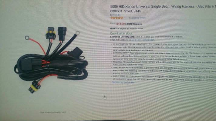

Can I use something like this?
Sent from my SM-N915T using Tapatalk

I have diode dynamics HID and have zero problem with factory harness direct to new HID fog lights.
For the low beam I erred on caution ran the relay harness direct from battery and got the anti flicker module as well.
Zero problems.
