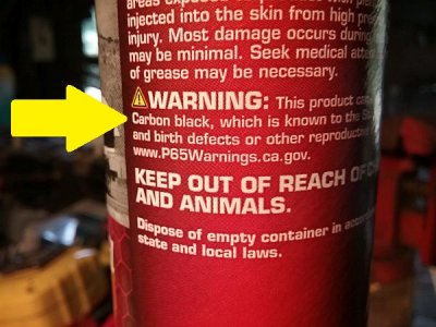

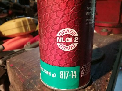

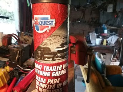

Below are 3 pics of the grease / tube - I bought -
I read where some greases do not mix well with regular lithium types of grease (which lithium is what I have already been using) They say that some greases will "de-activate" each other and either harden up with little lubrication - OR - liquefy with little lubrication.
The new grease is the thicker NLGI 2 - but it says "Carbon Black" (which is what they call the thicker (peanut butter) consistency greases)
I wonder if this stuff will play well with the lithium?

Why don't you mix the two on your workbench with a putty knife and see what happens? Or just take it back and exchange it?

After purchasing - I thought with it being thicker I wouldn't have to grease the cardan every oil change - maybe every other change - but then I did a little research about mixing - I'm just going to exchange it for some lithium.

It's two $12 u-joints. If he's greasing it that often he's pushing grease out the seals, might as well just use it and flush them through.
