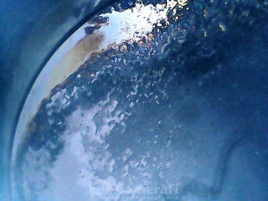

Tried to video the exhaust pipes while remote starting yesterday and no smoke at all lol. Like I said, it smokes very very seldom, but I have seen it happen. It still runs fantastic with no noticeable lack of power. Mileage was as expected when i bought it, and it has changed as expected every time Ive made a major change (lift/level, efan, rear gear).It's the 1 quart every two weeks thing with no obvious leak that worries me. In 2 weeks I drive between 300-400 miles, in 20-25 engine hours. I looked at my driveway again today and there are no big spots. Last time I changed the oil there was no obvious sign of a leak. I'll crawl under it tomorrow and check again. There's also no obvious leaks under the hood anywhere.
I have a 4 pack of the redline stuff in the Amazon cart that I'll pick up on payday. I guess one of those scope cameras to take a pic of the tops of a few pistons wouldn't be a bad idea either to track the progress. Is there a cylinder that is known for being dirtier than the rest for some reason? I'd for sure want to use that as one of test subjects.
maybe the closest ones to throttle body where the gunk is sprayed first.

I don't understand what you mean by that @Burla
the oil and blowby from pcv comes from back of engine, it in theory the back cylinders could have more carbon then front as oil burning is gonna make more carbon then gas, but yes this is just a theory. With those miles it is likely all the cylinders are caked good.
