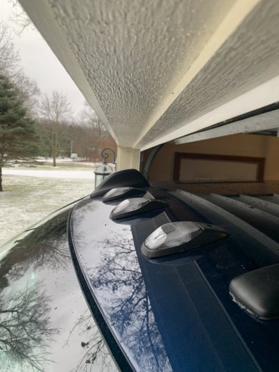

I have a 2021 3500 4x4 crew cab and I clear an 82” garage door by this much…
Thanks. The 3500 as advertised sits at 78.5” so based off your image I am now really fearful the 2500 wont fit.

Raised my ‘18 up to max and measured to the top of the shark fin; 79.25”. So the ram website was pretty close, if not spot on and I was off a bit in measuring.
With it at max height I slowly left the garage and had at least a few inches above the fin.

This is the 7 foot marker at the car wash, don't worry it's a brushless. '21 CC 4x4 (80.2 on the site)

Doesnt look like 4” of airspace, but maybe its the angle. Thanks for the post/info
Yeah I figured someone sitting the same height as your advertised height would make more sense to comment. I haven't tried in my garage, the truck wouldn't fit all the way in anyway.
