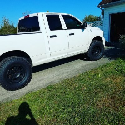

So I leveled my 2013 ram 1500 a couple weeks ago with Bilstein 5100's at 2.8". I also put 18x9 wheels and 35x12.5R18 grabber X3 tires on. I had an alignment done and everything is in spec, also tires balanced out fine. Im getting a decent vibration intermittently at highway speeds. It seem like 70mph is when it likes to shake. What should I look at or where should I start? Thanks in advance!

I recently had new wheels and tires installed after the dealer installed a lift on the truck and had vibrations between 62 and 75 or so. Tried switching from Nitto tires to BFGs, had hub centric rings made, had both sets of tires road force balanced a few times and still had vibrations. Discount Tire ordered a new set of the same wheels and that fixed the issue. Hopefully, the road force balancing will work for you. If not, it can be a step by step process until you finally find a solution.
