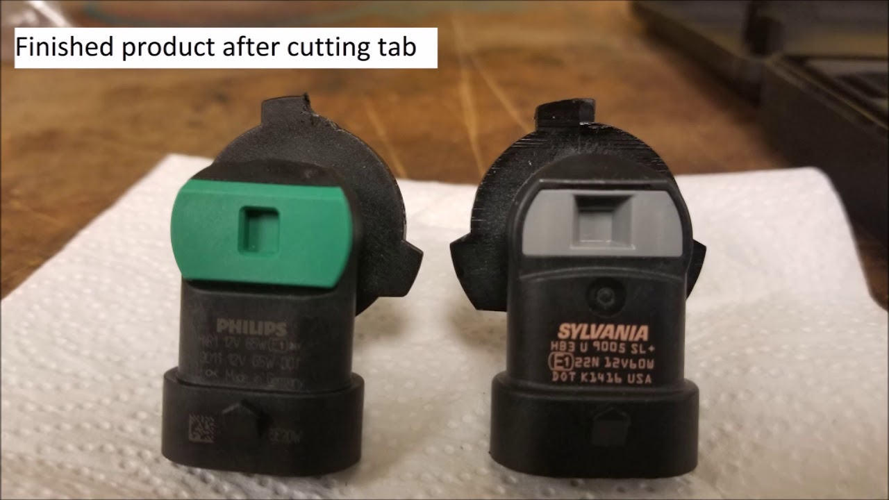

I have looked and found Videos and Instructions on Changing the H11 bulbs to the H9 Bulbs and although some use a Dremel tool or a Razor knife to remove the Metal tabs and the Plastic Piece this Method would seem to do the Job as well?
Is this the only changes that need to be done to the H9 Bulbs to fit inside the headlight housing ?
I looked and found a Video on Changing the 2005 Bulbs to the
9011 Bulbs and found this.
Is this the Only Change that needs to be done to the H9011 Bulbs to fit inside the Headlight housing ?
Although I think the guy is talking about changing to a HIR bulb, I think that the info is revelent to changing the size of one of the plastic tabs on the H9011 bulbs to Match the size of the 2005 bulbs to insert the bulb into the housing.
I also found this video about the 9011 Bulb Modification where the guy uses side cutters and ends up splitting the bulb but then uses a small fine file and accomplishes the job.
He talks very low though and is hard to understand.https://www.youtube.com/watch?v=xaNEGW7qxH8
Will these videos cover all the changes I need to make for the
H11 to H9 Bulbs AND all the changes from H9005 to H9011 Bulbs ?
I have been skipping around different sources of information so I can do mine and thought that this information would help others as well to find this information more easily.

The H11 to H9 and 9005 to 9011 conversions are to brighter spec bulbs.
Although I wouldn't bother swapping the 9005 to a 9011 for the high beams using a halogen bulb, better to use 9005 LED bulb.

I bought some h11 to h9 adapter cables. Turns out the adapter socket still would not attach to an h9 bulb, but i was a lot happier taking a dremel tool to a cheap, easily replaceable adapter cable than i would have been to cut the actual truck connectors. Also, that let me do all the modifications at a table rather than in the garage.
The H9s are significantly brighter than stock. Not like HID or LED, but until i get around to buying full LED projector assemblies I get better light, low cost and zero chance of CANBUS errors. Also less chance of glare for oncoming traffic.
