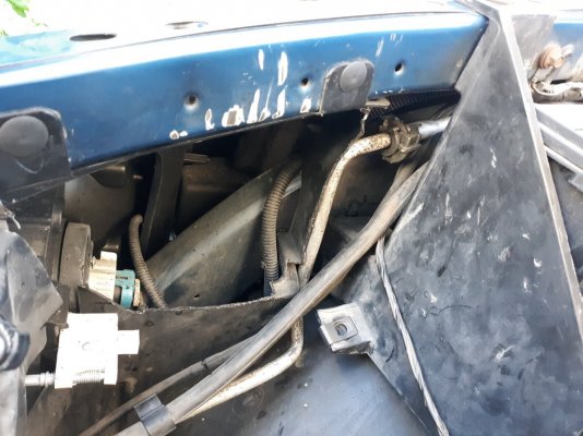

This is what I end up with. If you try this, be very careful of your AC lines. You can see where one of the previous owners gouged through the paint getting the original airbox out.

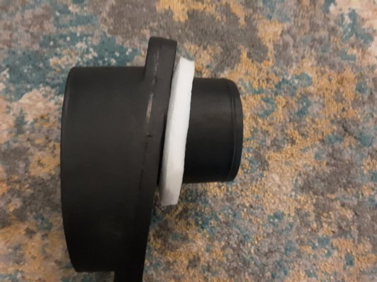

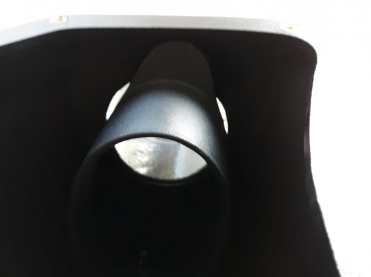

So the airbox and filter mount is a two piece affair and fit is.... questionable. This shows the gaps on both sides that point into the engine bay.

Not dealing with that. So I made a gasket out of some ballistic foam packing material.
Sealed up tight.
