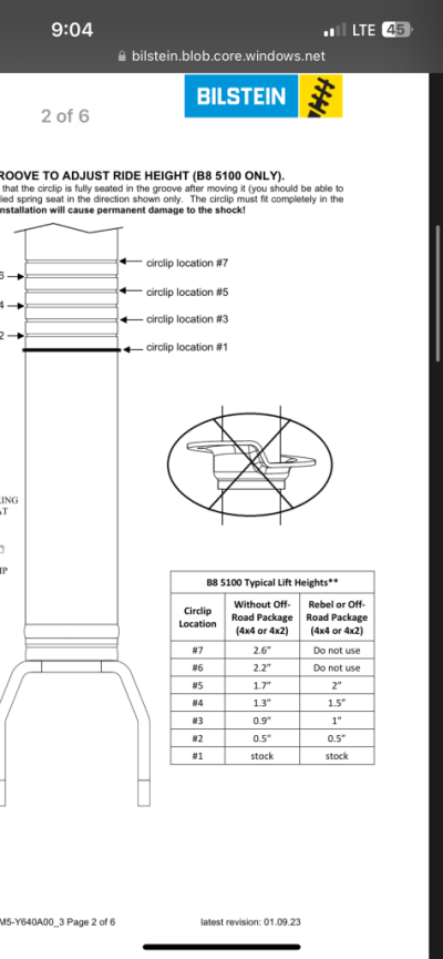

Hopefully I can revive this old thread and get clarification. So I have a 25 warlock and it looks to have the bilstein 4600 shocks and comes with the factory 1” lift or .7 whichever it is, so by removing the front 4600 shock that has the lift (circlip) I’d lose the factory lift correct? I’m installing the the 5100s to achieve a front lift/level with new uca’s. If I lose the factory lift by removing the factory shocks could I set it a the #7 clip to make up for the inch I lost removing the factory shocks?
If so why does bilstein say for the 5100 do not use past clip 5 for warlocks or off road packages?

I would measure your existing shock circlip position side by side against the new 5100, and go from there during installation. From my experience with my 2017, the 1" lift on mine is due to a slightly higher spring and not due to the strut, but mine is gen4.
Here's a link to a thread I started when I decided to replace the OEM shocks with Bilstein 4600's and what I found when I did. Maybe helpful?
