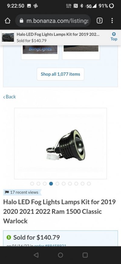

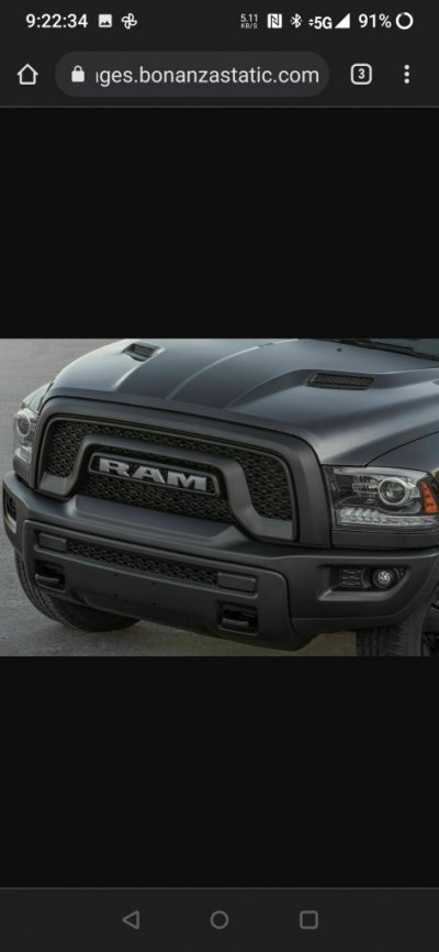

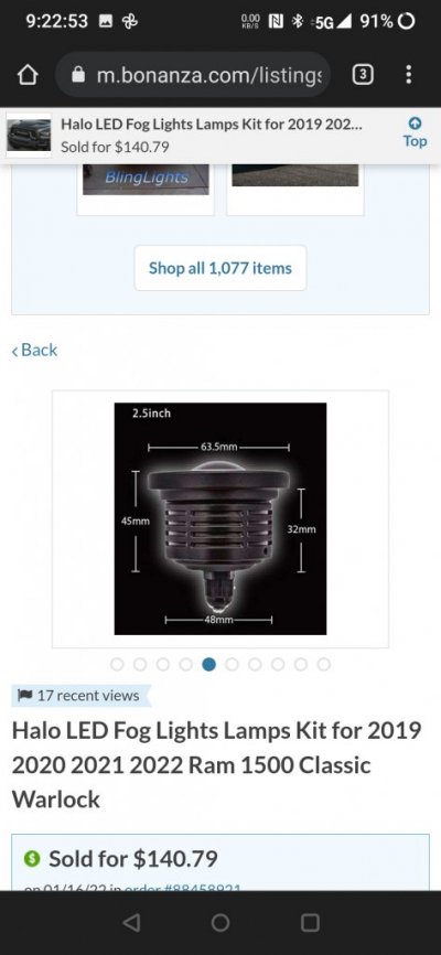

Like most warlock owners that weren't lucky enough to get their truck with foglights from the factory, I have been looking for ways to add them and not spend about 500 dollars. I ended up finding this alternative that might just work (fingers crossed). So I purchased the OEM bumper bezel fog light insert kit from ebay (pic attached) and some aftermarket fog lamps from a website and I'll post direct link down there. I'm hoping this works. I am a fan of OEM and was willing to go the whole 9 but I have seen that it's a headache so this will do for now. Then save enough money to just have the dealership install the factory ones with all the bells and whistles and the OEM headlight switch. I'll attach pics here as well and the install once everything comes in.

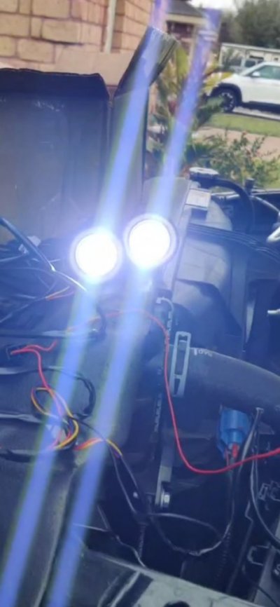

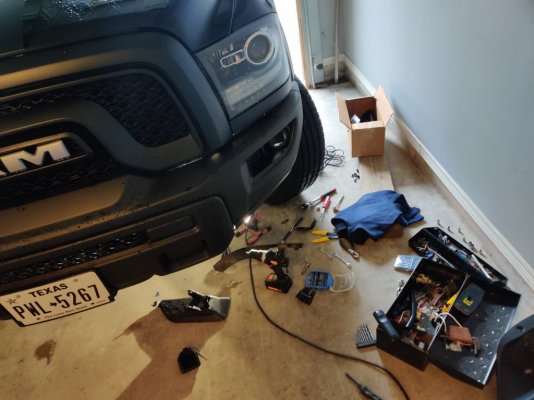

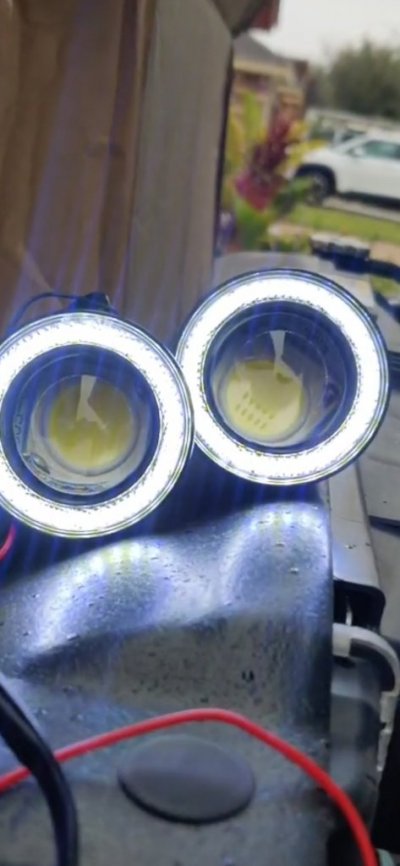

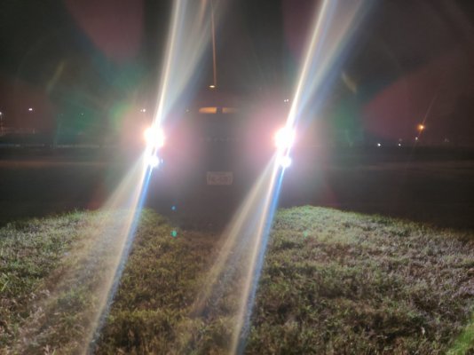

Well... They're on now. But I had to do some modifications. Hardest part was removing the old bezels and installing the oem ones. But the fog lights I ordered didn't fit flush in the oem bezels. The pic they posted on the advertisement is false. I'll keep these until I can buy oem ones, wiring, etc. If anyone has gone with the oem please let me know how hard it is or an estimate on cost?

Looks good, I put in the oem fog lights I paid $54 for each light. Will be easy to just all since you already did the hard part installing the bezel. You should be able to replace them through the wheel well

I want to put some fog light in my 2021 warlock, and for the fact that here in germany we hav problems with lights that are not state certified by the EU i want to look after some certified lamps in the aftermarket. So could one of you do me an favour and give me the exact measurement of hole the factory bezel?
So you were able to work through the wheel well and not remove the bumper??
