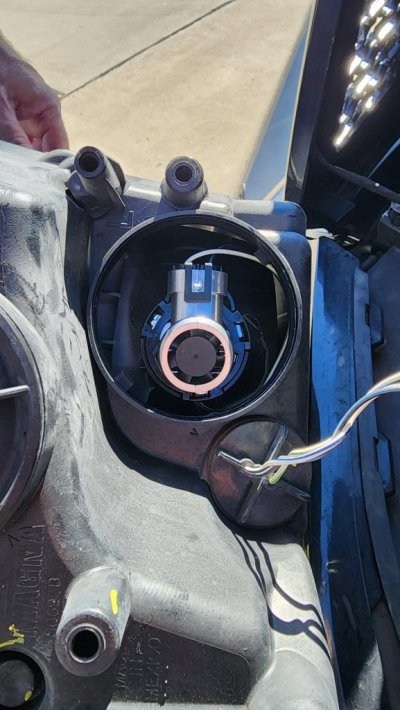

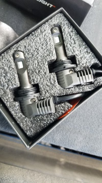

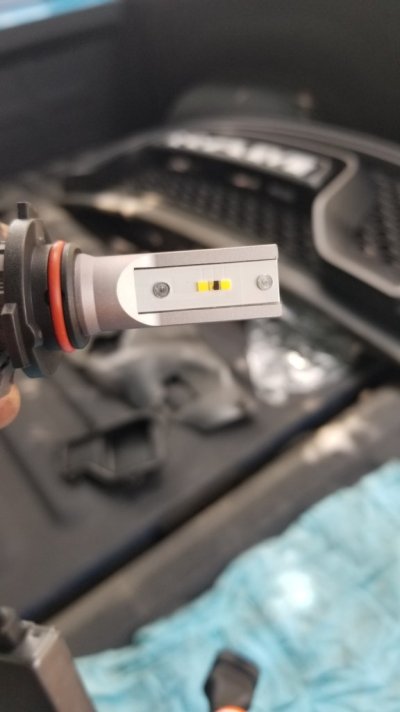

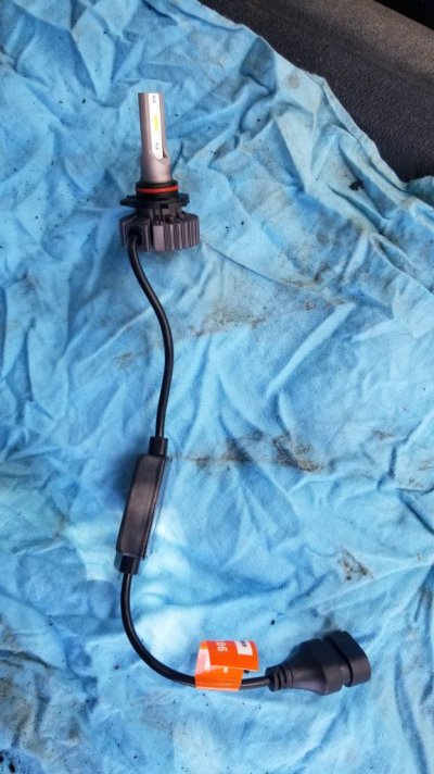

As it happens I just changed mine today. at 112k kms. I had installed these Amazon sealight leds (9005 hi/lo projectors) in 2021 at 5k kms. everything was perfect!
fast forward to this past Thursday get a low beam out message in the dash. go look everything seems fine. Friday same message go look and the passenger side low beam is definitely burnt.
start checking prices at Canadian tire and napa because I know they started selling these kind of lights and I dont want to wait for Amazon.
finally the prices are obnoxious (100+ cdn) so I start looking on marketplace and low and behold there are lots under 25$ and fairly close by.
found the perfect deal 10$ per set so 20 for 2 sets of 9005. the same brand as I had before but the next gen
overall Im very happy I was able to get a great deal quickly and everything is working fine so far
oh and you can see in the photo the old one clearly has a burned out diode
