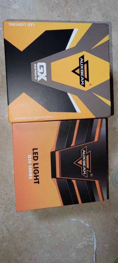

In my 2021 warlock i have auxbeam led no issues and it makes a huge difference

It was not bad have to remove the headlight assembly. I watched a u tube video the instructions in manual are not that clear. I installed them first of January so far so good. I was just going to do low beams. Since have to remove the entire assembly I figured better do both

I went with the q20 for low beam and the gx for high beam. I installed the fog lights myself with factory led. Mine did not come with fig lights. I also have projectors
