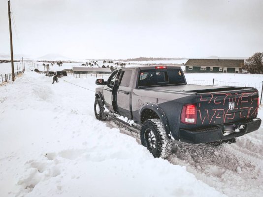

I winched three jeeps out last week, ya three of em with one being my wife's jeep. My winch never completely stopped but lets talk about snails pace, geezus.
It was pulling a massive load, zoom in to the end of the cable and check out the snow depth on the back of the red Jeep, but holy crap did it take a hot minute, especially since we were beyond full cable and there's no clutch / free spool mechanism. My flippin Can Am has free-spool and I think its a Harbor Freight winch.
The unspooling was the most painful part Mine very well could have been a code-18 (18 inches from the controls sits the problem :) ) but I crawled around down there for a bit and I didn't immediately see free-spool, so I sat in my truck and held the button.a4c00ccfb3166155307d0a53784db0c4.jpg

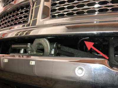

Um, yea there is most certainly a free spool lever LOL. Does anyone even make a winch without one?!
I watch an Aussie program called 4WD Action and the hosts NEVER freespool. Not sure if the winches they use don’t have it, or if they’re buried inside bumpers with no easy access to the freespool controls.

Look the right of the fairlead for a shiny thing that looks like a freespool lever.
LOL, figured there was, I was just too big a ...... to find it, but I really wanted someone to Say It was there, thanks.
2016 RAM 2500 pw | 392ci w 6spd | CAI w ARH long tubes & Solo | Diablo T2 w HF tune | 5.13 AAM w 35" Mickey MTs | Custom Graphics w illegal tint | Dodge Off-Road
Its to the right of the winch, right here....
you all rock and thanks for the photo because I popped a quick squat in the parking lot before driving home, and I didn't see any shiny thing next to fairlead that looked like a free spool mechanism. I just saw those ********* winch mounts, but I did not look where you are pointing, I'm really excited because the e-unspool sucked, so thank you! O.P. thanks for the winch post, didn't mean to hijack it in the least but I did a bit. I'm going to go outside, 11F w no windchill, find and yank my lever at least once (winch free-spool lever, really)

If I remember correctly it twists to the passenger side to free spool, and then back to driver side to lock it back up.
