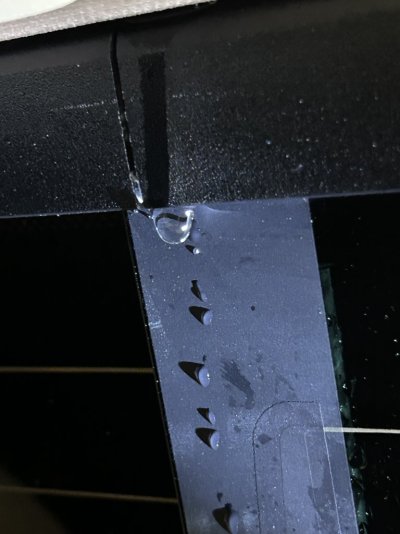

OK My turn at the leaking rear window and 3rd brake light on my 2020 Ram 1500 Big Horn. We noticed a couple of week ago that the headliner had staining on it after some heavy rain we had. Upon closer inspection it was indeed wet. Our truck only has 21K miles on it and is in like new condition as we do not drive as much since we are retired.
Made an appointment at the dealer about the issue and was told that there is a warranty extension to replace the 3rd brake light which was done.
They also found out that the rear window was leaking and did the urethane seal which did not work at all. First rain and it again soaked with headliner and rear seat. So back to the dealer again. Here is a picture showing clearly the cracked frame with the leak.
Now the dealer service center wants to have the rear window replaced as the frame is cracked in 2 spots. Total cost around $1700 even though the dealer is not going to do the install but instead have a window glass company do the work while all the dealer does is simply supply the replacement window. It is probably better having a window company do the work at this point as the dealers service is anything but competent given they gave me my truck back the first time without even checking to see if they actually stopped the leak..
The dealer did check for a cost sharing with RAM and said that it would be a 60/40 split and I would still be in the hook for around $700. But they would NOT call RAM to see if they would cover it in full. They just simply gave me the 800 number and said good luck.
This is absolute BS from RAM as this was a known issue for multiple years. I will try calling and talking with their "care team" but doubt I will get anywhere. I already filed a complaint online but as expected no reply.
I will most likely get the work done and then just dump this POS since the dealer will not do anything about preventing mold from forming on either the headliner or seats and I don't want to deal with this down the road. So this will most likely be another brand that I will not purchase along again along with Ford who also would not honor a safety issue that almost resulted in an accident when the front suspension frame mount rusted out resulting in the loss of steering. Ford basically said to me in an email that if I don't like their response to just sue us. So it will interesting to see what RAM says but my guess is that their offer to cover "some" of the cost will be the best I can do.

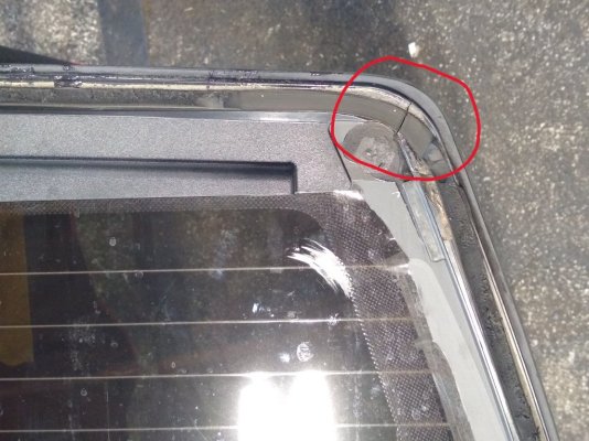

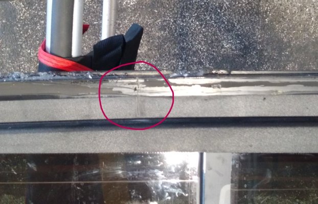

Useless service managers at local CDJR said the CHMSL was the likely culprit so I bought a new one for $28.00. The new assembly gasket was noticeably thicker as shown:
Leak test with water hose showed this was not the issue and feeling around the inside by where CHMSL mounts as well the shark-fin antenna were dry.
I attempted to use Permatex window repair flowable silicon with a precision syringe but a rainstorm a week later with a steady drizzle showed that was a waste of time.
I went with replacing the rear window on my own vs. wasting multiple days, time, energy & trips to the dealer. Besides, the local Safelite is who the dealer sends all their glass-work to anyway. Safelite technician says the company's seen quite a number of rear windows of RAMs with this issue. He was cool enough to let me see the replaced window and pulled/scraped the gasket to show me where the cracks in the frame were as shown in these pics:
Drivers side rear
Drivers middle side rear
Curbside side rear
Curbside middle side rear
So BLUF is there were four damn cracks in the frame that CDJR has sent out TSBs for and it's a crapshoot to get this defect repaired under warranty. Sorry for the long post but the word needs to be kept going and feel free to share the pic as needed for the myriad of threads here relating to leaking rear windows for our model of RAM.

Thanks for the detailed report and for including all the pics.
Could you please clarify something that isn't clear to me? Perhaps the info is in some of your other posts on the topic.
Are these pics of the back window frame from your truck that was previously replaced by Stellantis?
And you had Safelite replace this defective frame to finally resolve the leak?
TIA
11B-33T
Oct 20, 2023
10
23
AZ
HEMI 5.7
TIA
- The back window frame was OEM as far as I know as I'm 2nd owner.
- I had Safelite replace the entire assembly out-of-pocket rather than the aggravation of dealing with Stellantis as well as the local CDJR dealer.
- Leak testing with hose as well as a trip thru the swirl-o-matic car wash revealed no leaking. (knocking on wood)
