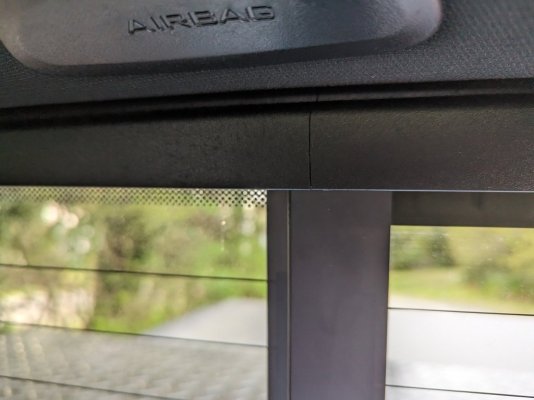

Well finally got an update from Ram Cares and it seems I'm hosed on this one as they'll replace the third brake light but since I don't have the right VIN I'm on my own for the window replacement. Just boggles the mind how I can meet all the criteria except the VIN one. Back window is textbook for the service bulletin but reckon that isn't enough. Have to say Ram Cares is not living up to their name as I still haven't received an explanation on how the VIN's cut-offs were assigned and what the issue was to begin with. Reckon I'll have to hope an adequate dose of permatex sealant and new third brake light can hold the water at bay until I can trade the POS in, lol.

I agree...just doesn't make any sense. My window frame crack looks pretty similar to the one they used in the service bulletin, lol.
