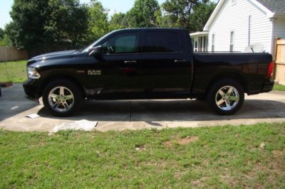

Yep the weather has been crazy here. We went about two weeks it seemed with on and off showers almost everyday. I think my water spots have water spots....:(
Below was about five hours worth of work.
