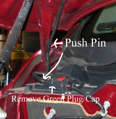

Since it's a Classic, it should be very close to my 2014.
Which also did not come with a Under Hood Light.
here is what I did.
if you're just looking for Power, look for this= clip. Mine had a green dead end plugged into it.
Passenger side of truck. Near hood hinge. Top of Firewall or there abouts.
Removed the green filler Cap and plugged fsactory under hood Light kit into it.
Imagine you could just snip the plug off, install your own plug or Tin the connections, direct, and heat shrink them.

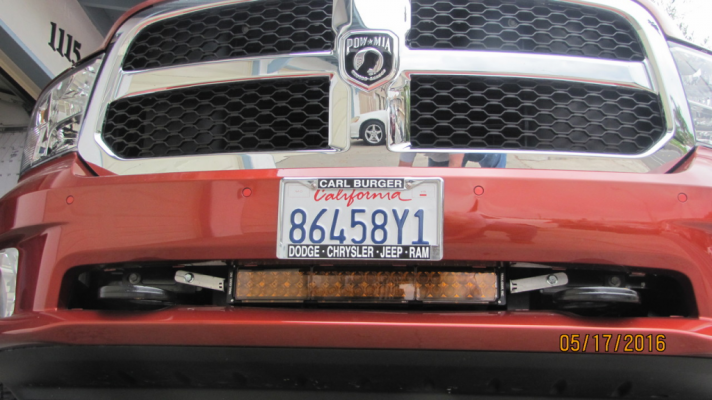

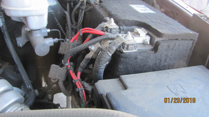

My short lightbar wiring, goes from my battery to a inline fuse that is real close to the battery, then the wire passes through the blocked off firewall plate to a lighted Rocker Switch, then another wire goes back through the firewall & goes behind the battery & fuse box & then follows the wiring for the AGS, the lightbar is almost under the AGS
3 inline fuses , Light Bar, CB Radio, Rotating Lights above the cab
