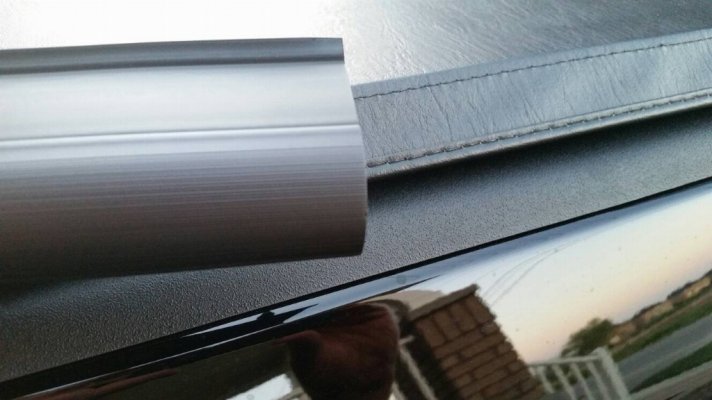

Picked up my weather strip today at dealer. Cost me $ 18.75 taxes in

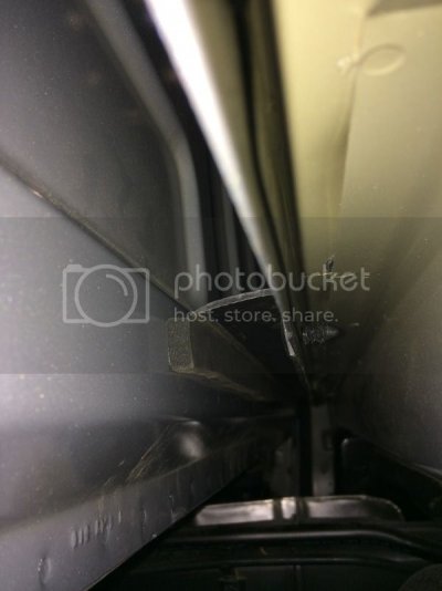

Not sure if you can see it in pic but the edge that touches cab is not smooth either65fb4347fa325befaf4381c3b0a27d2c.jpg

I'm wondering if the bed and cab are farther apart on some trucks than others. On mine the weatherstrip is jammed up against the cab. So with that said, is there much adjustment in the bed to move it say 1/4" to the rear to stop this rubbing?

A buddy of mine has a 07 ram and sure enough, that seal is there and it is rubbing the **** out of his cab.

Agreed. I still need to look at mine but if it was rubbing I'll be cleaning the area and hitting it with some red rustoleum paint to keep it from rusting.
