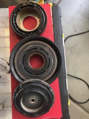

Wow, $175 for a connector. and i thought the clutch assembly was expensive ($210). good thing you have the option to just hard wire it. kind of hard to do with a clutch unless you weld it together. but then the a/c would run all the time.AC clutch.jpg

Mine stopped blowing cold today, when it hit 97.:mad:
Nothing but warm air. Middle of pulley has a ring of rubbery goop around it, and the very center isn't spinning. I'm thinking compressor clutch maybe?
yep its your clutch. the seal flange thingy melted. they used a rubberized mechanized clutch throw instead of metal. mine went out in 115* out on a desert road. the wife was not happy. its taken two weeks to find just the clutch which i can change in the driveway and not pay $800+ for someone to crack open the A/C system. https://www.ramforum.com/threads/a-c-clutch-melted.166012/
