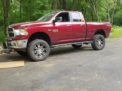

Alignment in the morning. But she's finally done. Now time to hunt down some 36"
